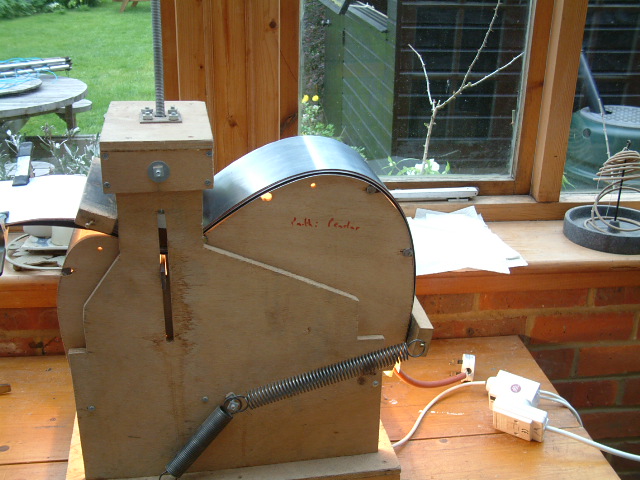

I was bending some walnut last night for a European walnut and Italian OM when I got to thinking that I was clamping cauls directly against my blanket. OK I've been doing this for years but I got to thinking, (dangerous thing to do), does any one put an extra slat or even foil/kraft paper on top of their blanket to protect it?

I do from top down: slat/blanket/slat/wood (wrapped in brown paper or baking parchment)/slat. The picture isn't totally clear

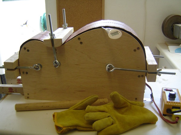

Sounds like I'm the only one here who puts the blanket down on the mold and stacks everything else on top of it. This works fine, as long as the blanket is pulled tight at the ends to take the slack out of the waist area.
For easy-to-bend stuff, like well-quartered EIR, all I stack on the mold is (in this order) the blanket, the side, and the caul. Works great. For more difficult woods, like mahogany or padauk, I use slats and wrap the wood in foil and paper towels.
